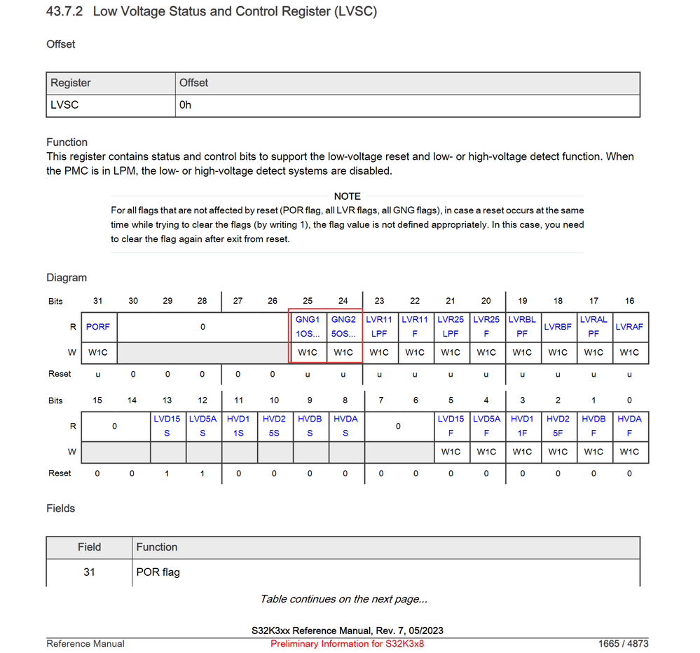

Can I understand it this way:
The difference between these two GNG bits (GNG11OSCF, GNG25OSCF) and these two LVR bits (LVR11F, LVR25F) is that the GNG bits only concern whether the power supply to the clock is normal.

Hi @Pusoy,
Yes, that is correct.
