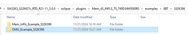

I just obtained an example code from SW engineers. I am sharing it as it is including description below:
This demo can implement how to remap the Flash address to one specific RAM address, and how to config the overlay region.
Development Env:
  • RTD: SW32K3_S32M27x_RTD_R21-11_5.0.0
  • EB Tresos 29.0 config the project and compile the project with the command line
  • Debug tool: Lauterbach. One debug script is in the example package
Debug steps:
  • To minimize the environmental deviation, please extract the package into the following position:
  • Replace the original RTD package file(C:\NXP\SW32K3_S32M27x_RTD_R21-11_5.0.0\eclipse\plugins\BaseNXP_TS_T40D34M50I0R0\header\S32K37_OMU_CM7.h //  C:\NXP\SW32K3_S32M27x_RTD_R21-11_5.0.0\eclipse\plugins\Platform_TS_T40D34M50I0R0\startup\src\system.c) with the following hotfix file
  • Change the path to the following position, and use make build command to build the project. using make clean to clean the project
Hope it helps

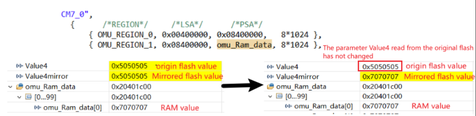

I am testing the memory overlay functionality for the S32K396. I have established the relationship between Mirrored Flash and RAM by using OMU.
  • Modify the value of RAM and the value of mirror flash is also changed.
  • When I read the original flash value, it still remains unchanged(The value of the mirror flash changes and should be read through the original flash.)

  • How to correctly read the changed value of Mirrored Flash through the Origin Flash address?
  • How to implement the request to read the original flash, S32K396 automatically reads the variable value on the ram address through OMU mapping?

davidtosenovjan
I think it is correct, it worked this way on predecessor platforms as well (MPC57xx) i.e.
original flash address = physical address
mirrored flash address = logical address
calibration (overlay) runs above logical address and what is actually what you see (if I understand it well) that is changing data in RAM leads in changing of data in logical flash address
