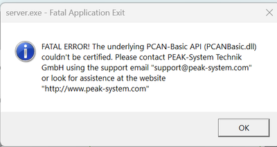

I'm trying to use S32K144EVB with NxpOpenBus-win32-x64_v0.9 via the CANbus, using a PEAK PCAN-USB Pro. I am not able to 'Connect Device':
"FATAL ERROR! The underlying PCAN-Basic API (PCANBasic.dll) couldn't be certified..."
I found PCANBasic.dll in two locations:
1:
c:\windows\system32\PCANBasic.dll:
Verified: Signed
Description: PCAN-Basic API Library, x64
Product: PCAN-Basic API
Prod version: 4.8
File version: 4.8.1.872
MachineType: 64-bit
2:
c:\windows\syswow64\PCANBasic.dll:
Verified: Signed
Description: PCAN-Basic API Library, x86
Prod version: 4.8
MachineType: 32-bit
Please help with this.
Thank you

Hi, I too have this problem. I'm using a PCAN-USB FD., with drivers 4.5.0.16741 with the PCAN-Basic API 4.9.0.942.  Have  you @pawl found a solution to this problem?
