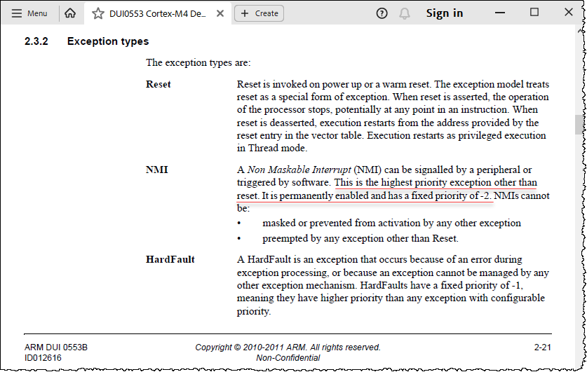

This is the introduction to NMI in the Cortex-M4 Devices Generic User Guide:
A Non Maskable Interrupt (NMI) can be signalled by a peripheral or triggered by software. This is the highest priority exception other than reset. It is permanently enabled and has a fixed priority of -2. NMIs cannot be:
• masked or prevented from activation by any other exception
• preempted by any exception other than Reset.
NMI fixed priority of -2 Cortex -M4 Devices Generic User Guide.pngNMI fixed priority of -2 Cortex -M4 Devices Generic User Guide.png

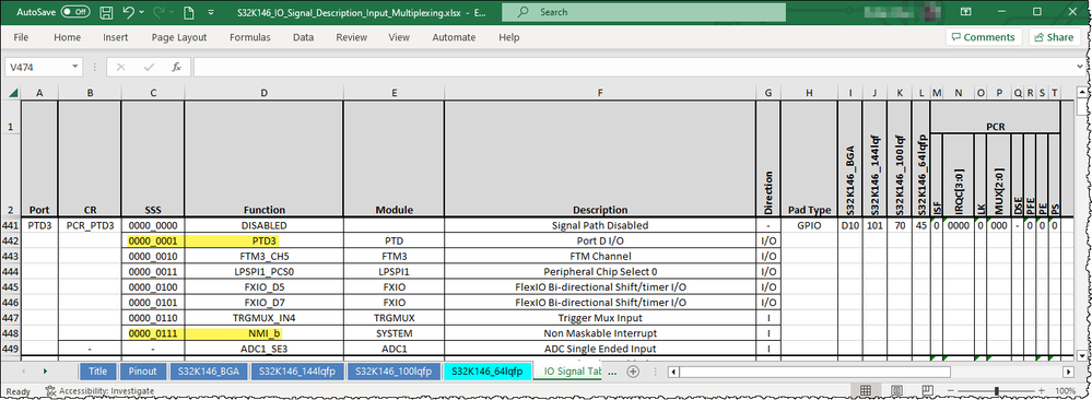

Have you considered configuring this pin as PTD3 to enable the PORTD interrupt and configure its priority?
PTD3 SSS S32K146.pngPTD3 SSS S32K146.pngS32K1xx_DMA_Interrupt_mapping S32K14x_INT_MAP_ARM PORTD Interrupt.pngS32K1xx_DMA_Interrupt_mapping S32K14x_INT_MAP_ARM PORTD Interrupt.png

yes, I config the PTD3 and interrupt function (no NMI function)
