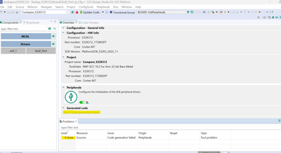

SandyHCL
Hi @VaneB  We are seeing an error for peripherals. It is stating as tool problem. Please refer to attached image.
4,904件の閲覧回数
VaneB
Hi @SandyHCL
This issue could be caused by code generation timeout due to computer speed.
By default, the Peripherals Tool has 15 seconds allocated for code generation (which should be more than enough). If code generation scripts do not finish executing during this time, the code will not be generated.
As a workaround for this issue, code generation timeout can be increased by adding the following argument into the s32ds.ini file (default path could be C:\NXP\S32DS.3.5\eclipse\s32ds.ini, it depends on the version of S32DS).
-Dcom.nxp.swtools.codegenscript.timeout = 60000 (It will increase code generation timeout to 1 minute) or, -Dcom.nxp.swtools.codegenscript.timeout = -1 (Remove the timeout).
After adding any of the previous options in the .ini file, restart S32DS and create a new workspace.
Try this workaround and let me know the result.

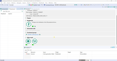

SandyHCL
 Hi @VaneB In Peripherals window, there is no peripherals listed - Refer to the attached screenshot. Can you please help me?
4,935件の閲覧回数
VaneB
Hi @SandyHCL
The Drivers can be added in the Components window.

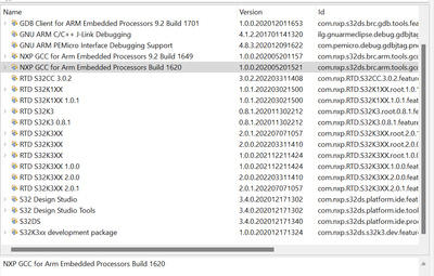

VaneB
Hi @SandyHCL
Could you provide an image of your S32DS Installation details? When you try to update the code, does S32DS show an error or something?

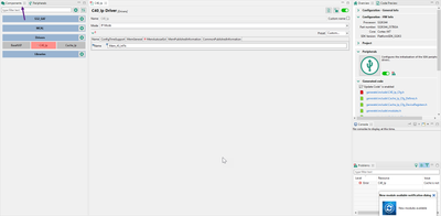

4,997件の閲覧回数
SandyHCL
@VaneB Here is the installation details screenshots
I don't see any error during update code generation.
4,951件の閲覧回数
VaneB
Hi @SandyHCL
The packages look to be correctly installed. Could you try uploading the code to the MCU and let me know if S32DS shows any errors?
