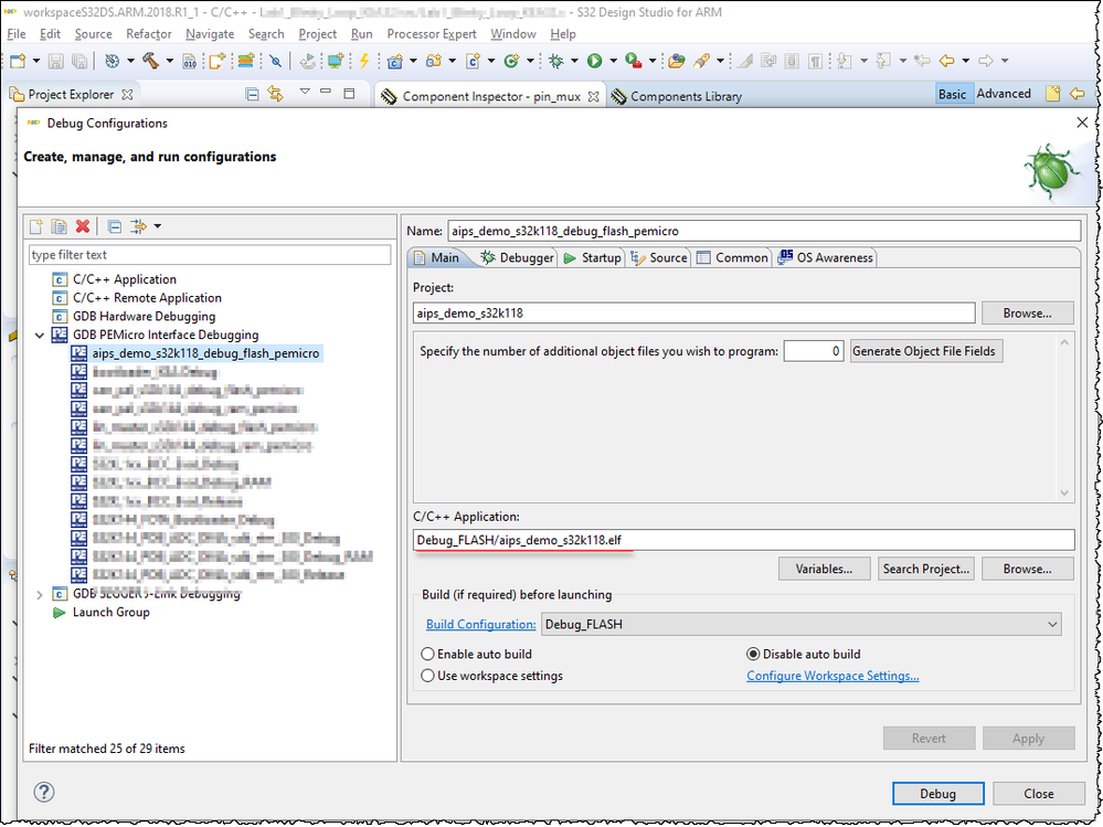

I am trying to debug a program in S32 Design Studio, but when the program loads, it is showing No Source available for main() instead of stopping at main.c, I am unable to use any debug commands.

Please check the path of .elf in Debug Configurations view
