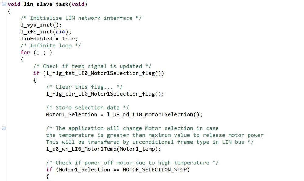

I am trying Lin_Slave_S32K148 example with S32K148-176 board. But slave is not responding. Can any one help me to sort this issue.

I generated the processor code with 176 pins package of S32K148 and selected LIN1 using LPUART0 and used SBC-UJA1131HW5V0. I am using external tool to act as a master but the slave is not responding to the headers and not getting the response send by the Master. PFA of code I am not receiving anything from l_u8_rd_LI0_Motor1Selection()linslave.JPGlinslave.JPG. Please let me know anything I am missing or any changes required.

First I used LIN_Master_S32k148 example with S32K148-Q176 if I use the example I am not getting any frames from the LIN interface. After making some configuration changes master is sending the frames from the LIN1. The same process I followed for slave with LIN_Slave_S32K148 and I used tool as a master that tool sends the frames using LDF file. The slave is not responding, Please let me know what is the reason I didn't modify the code.

The LIN_slave and LIN_master examples are designed to work together. That is the reason you need two EVBs.
If you want to test the slave example with an external it going to need to make some changes. I do not know what tool you are using so I can not help you in that regard. The implementation in that part is up to you.
