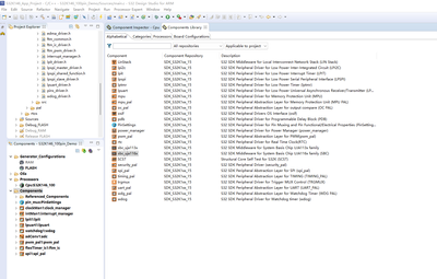

Hello EveryOne,
I do not find CAN module listed in Components Library for S32K146, whether the SDK not support CAN module? if support, how to find the conpinent.
Detail information as the follow picture.

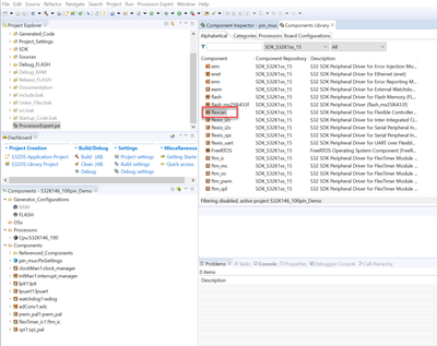

Senlent
Hi@547416104
please change the Applicable to project to All,then try again.
3,271 Views
547416104
Hello Senlent,
I have try to do follow you suggested, the the result is the same, I have attached the demmo project, could you help to check the problem, thanks.

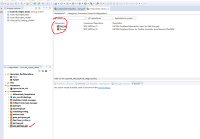

547416104
Hello Senlent,
I have add the can_pal module in project, I must reopen the S32DS IDE, otherwise, I can not find the CAN module, thanks.
