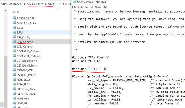

Senlent
Hi@Ajesh
1.first, you can refer to this post, the hardware is S32K3X4-T172 with TJA1143
https://community.nxp.com/t5/S32K/FlexCAN-driver-on-S32K3X4EVB-T172-EVB-can-t-access-via-PCAN/m-p/17...

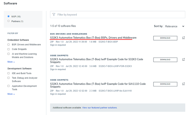

2.S32K3 Automotive Telematics Box (T-Box) Reference Design Board,
https://www.nxp.com/design/designs/s32k3-automotive-telematics-box-t-box-reference-design-board:S32K...
In this demo ,also have flexcan demo for your reference.
