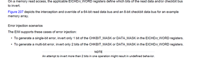

I’m able to hit the SRAM ISR (ERM0_ISR_Handler) for single-bit errors, but the handler is not being called for multi-bit errors.
As far as I understand, a non-correctable error event corresponds to a multi-bit error, correct?
I can see that the SRAM non-correctable error event bit is set in SR0, but the ISR is not being triggered.
Could you please help me understand how to call the multi-bit error ISR?
I enabled interrupt notification for SRAM0 in CR0 register also

Hi @Anitha7,
I updated the example by adding uncorrectable error injection into SRAM0.
https://community.nxp.com/t5/S32K-Knowledge-Base/Example-S32K344-EIM-ERM-DTCM-SRAM-Baremetal-v3-0-S3...
Can you read the VTOR register in your application?
The interrupt vector table must not reside in SRAM0 when injecting an uncorrectable ECC fault into the memory.
Otherwise, the ECC fault would corrupt the vector table during a fetch leading to another fault exception.

Hi @Anitha7,
Uncorrectable faults trigger a CM7 fault exception.
In the example I linked, I enabled the Bus_Fault exception, but with a lower priority than the priority of the ERM handler so that the ERM handler is called first.
I believe this might be the issue in your project.
Also, double-check the VTOR pointer and ensure that the ERM interrupt is enabled in the NVIC. You may notice the interrupt pending in NVIC.
