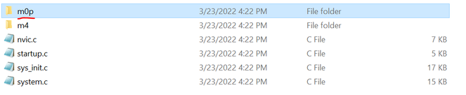

Hi@MohameddRIAD
sure,
If you have installed RTD, you can actually find the corresponding link and startup file in the following path
etc:
startup
C:\NXP\S32DS.3.4\S32DS\software\PlatformSDK_S32K1_2022_02\SW32K1_RTD_4_4_1_0_1_D2202\Platform_TS_T40D2M10I1R0\startup\src
Linker file
C:\NXP\S32DS.3.4\S32DS\software\PlatformSDK_S32K1_2022_02\SW32K1_RTD_4_4_1_0_1_D2202\Platform_TS_T40D2M10I1R0\build_files\gcc

I am attching it for your reference.
