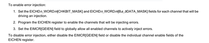

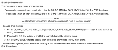

According to the NXP S32 Reference Manual, I followed the steps to inject a RAM error:
  1. Enabled the SRAM0 channel.
  2. Configured the EICHD0_WORDm[CHKBIT_MASK] and EICHD0_WORDm[Ba_bDATA_MASK] fields for the channel used to inject the error.
  3. Programmed the EICHEN register to enable the corresponding injection channel.
  4. Set the EIMCR[GEIEN] bit to globally enable all configured error injection channels.
To create a multi-bit error, I inverted two bits in either the CHKBIT_MASK or DATA_MASK fields of the EICHDn_WORD registers.
After that, I configured the ERM (Error Reporting Module) to monitor error status. However, when I checked the ERM_SR0 register after performing the multi-bit injection, I did not see any error status reported.
Could you please help me understand how to detect the multi-bit error status correctly? I have already enabled the ERM module clock. Is there anything else that needs to be configured?

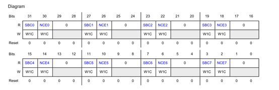

As there is nothing to configure in ERM for reporting of status of detected ECC error, I assume your error was not injected. Otherwise you will see it in SRx register of ERM.
Did you perform read of the address where you inject the error? The ECC will come when you read the corrupt address. As ECC mechanism will compare the data in the memory with syndrome and then decide if it match. Such can be done only on reads.

I configured the system for an SRAM0 as per your reference. uncorrectable ECC fault occur(NEC0) by setting the corresponding bit in the SRO register.
I enabled interrupt notification for NEC0 and single bit event in corresponding CR0 register.
After Non correctable ECC fault occurs, control transfers to the system call function, software not working after that until i perform reset. The ERM_1_Handler is not being triggered, even though I have added it. For single-bit errors, the ERM_0_Handler is triggered correctly.
What should I do to ensure that the ERM_1_Handler is invoked when a multi-bit (uncorrectable) ECC error occurs?
Also, just to confirm — does a multi-bit error(double bit error) always indicate an uncorrectable ECC fault?
