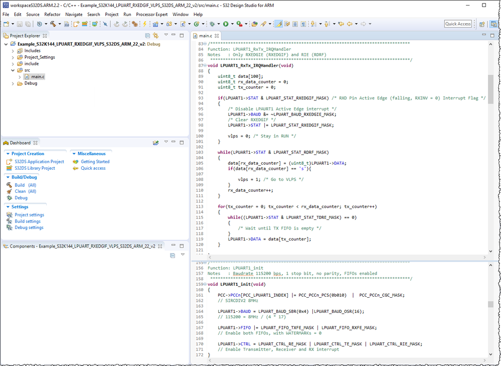

Hello NXP,
I am having an issue with LPUART Rx via interrupt,
I have used following code using the macros from library header file s32K144.h,
The Tx works perfectly fine, But Rx is recieved with garbage. There is an obeservation
that RDRF bit gets disables before we read DATA register. I am not sure how this is related to
my issue but It seems incorrect for me though(as per RM Page 1707).
Please let help me in debugging the issue...

Robin_Shen
Hi FrustatedEngineer,
Please refer the Example S32K144 LPUART RXEDGIF VLPS.
Hope it helps!
Robin
