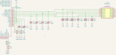

Have you created your own design or are you using our Evaluation boards. Please share your schematic with voltage levels and part values if you have created your own design. If you are using our EVBs, please share the full board numbers of all EVBs you are using.

We don't use an EVB for the MC33772B and the schematic that we use is shown in the figure below.

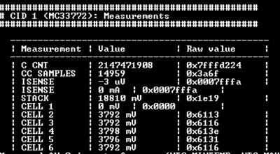

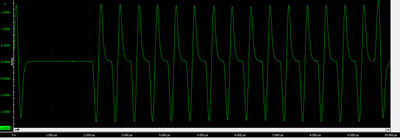

Because we are able to communicate with the first node in the chain the cell voltages are shown below together with the voltage of the TPL connection.
cell voltages.pngcell voltages.pngTPL_voltage_scope.pngTPL_voltage_scope.png
