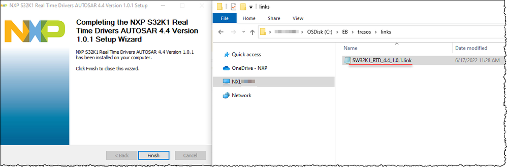

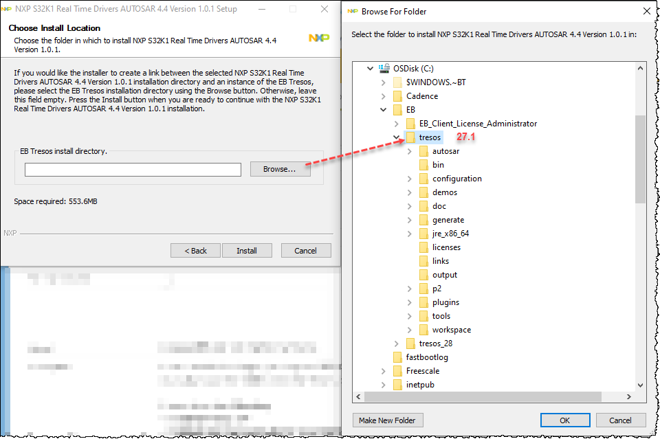

I'm trying to import files from 'SW32K1_RTD_4.4_1.0.1' to EB Tresos. However, I keep running into this error. Any thoughts?
5,261 Views
Robin_Shen
Please read the SW32K1_RTD_4.4_1.0.1_D2202_ReleaseNotes.pdf and then follow the steps:
