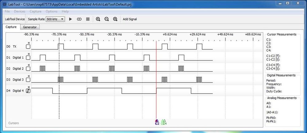

swatimali
I am using s32k144 controller I want to produce  PWM waveform with modulation feature.  If I use modulation feature is it possible to generate PWM with different durty cycle in their on time. for example if on time is of 40 msec and period is 60 msec, then for 20 msec 80% duty cycle and for next 20msec 20%duty cycle. How to generate this kind of waveform.

allen_willson
Swati,
I created a demo using 3 of the 4 FTM channels on S32K144, which uses the Fault pins to modulate a frequency output for any duration within your desired period.  In the attached image, the signals on traces D0 and D1 are used to modulate the PWMs that are being output on D2 and D3.  The signals on D0 and D1 are generated by FTM0, and are wired to the fault inputs on FTM2 and FTM3.  FTM2 and FTM3 can be configured to generate independent PWM signals.  When a fault is active, the PWM is not output on the pin. The period is defined by FTM0, and this is shown on trace D4.
This method uses a lot of FTM resources.
Source code is attached. Sorry, but I don't think it is commented very well yet. You can contact me if you have questions.
-allen

allen_willson
The SIM->FTMOPT registers perform the modulation function described in the reference manual section 45.1.7 FTM Modulation Implementation.  This is similar to what the demo performs, but not does not allow using across more than one FTM.  The diagram at Figure 45-4 FTM Output Modulation shows the direct influence of the channel FTM1_CH1 to the FTM0 output signals.  The limitation is that all signals of FTM0 are modulated by FTM1_CH1.
