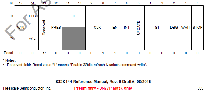

Regarding the watchdog timer :
I used the code given in the reference manual for watchdog configuration
DISABLE_INTERRUPTS(); // disable global interrupt
WDOG->CNT = 0xD928C520; //unlock watchdog
while(((WDOG->CS & WDOG_CS_ULK_MASK) >> WDOG_CS_ULK_SHIFT) == 0); //wait until registers are unlocked
WDOG->TOVAL = 256; //set timeout value
WDOG->CS = WDOG_CS_EN(1) | WDOG_CS_CLK(1) | WDOG_CS_INT(0) |
WDOG_CS_WIN(0) | WDOG_CS_UPDATE(0);
while(((WDOG->CS & WDOG_CS_RCS_MASK ) >> WDOG_CS_RCS_SHIFT) == 0); //wait until new configuration takes effect
ENABLE_INTERRUPTS(); //enable global interrupt
if(WDOG->CNT >= 125)
WDOG->CNT = 0xB480A602; // refresh watchdog
in the above code , control not come out of the while(((WDOG->CS & WDOG_CS_ULK_MASK) >> WDOG_CS_ULK_SHIFT) == 0);
Kindly help in this.
Ambarish

danielmartynek
Hello Ambarish,
The problem is in the maskset (0N77P).
Please use either 0N47T or preferably 0N57U which is the production version.
There are many differences between 0N77P and 0N47T/0N57U.
The current RM is not compatible with that maskset.
WDOG_CS[ULK] is not present on 0N77P thus it reads 0.
17,665 Views
