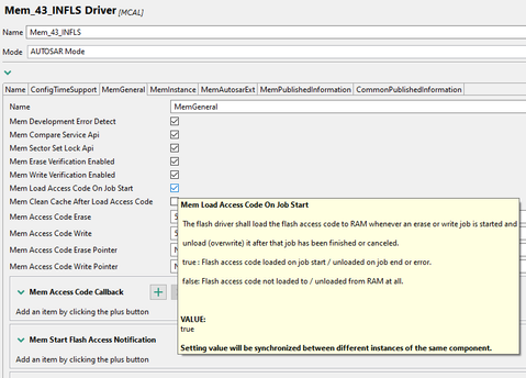

Hi @FelixR,
If you have the MEM_43 code in the same block as the one you program, there will be RWW issues.
The code should be placed in either another flash block or SRAM.
Refer to the User Manual MEM_43 driver.
BR, Daniel

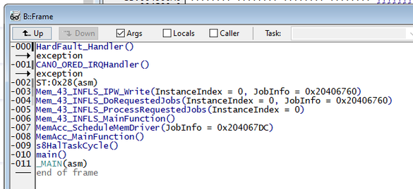

I did find the solution for my error which occured only during ISRs.
The Driversetting wasn't the problem with loading the write function into the SRAM. The problem was that while I was writing into my C-Flash block 0 an ISR was triggerted. The Code of the ISR was placed inside this C-Flash Block 0, resulting in a RWW error.
This explains why it was working inside other Flashblocks and while interrupts were disabled but not while the interrupts were enabled.

Hey @danielmartynek,
I thought so too that there might be a RWW error when targeting errors inside the same Code-Flash block. But that is not the case.
I tested writing Data into the C-Flash Block 3 while the Code was executed inside the C-Flash Block 0. There also the HardFault happened.
Also I tested the Settings you highlighted inside your picture. This also didn't help and the HardFault was still present.
I checked the Stack-Trace before the HardFault was called and noticed, that the CAN Error-Interrupt somehow takes part in this.
Now, removing the CAN-Error Interrupts did solve my problem. Now the C-Flash can be written. But how is this related? This Code executed inside this error Interrupt is also not inside the C-Flash Block 3 I'm trying to write?
