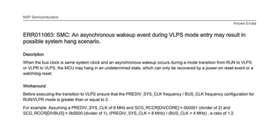

This issue may be caused by clock configuration. This is described in ERR011063 (from S32K146_0N73V
This only applies to routines which enter VLPS mode from VLPR mode, which in your case applies. Please try changing VCCR configuration.

Is VLPR needed for the project? It can go from RUN to VLPS directly. This will also mitigate the risk of ERR011063.

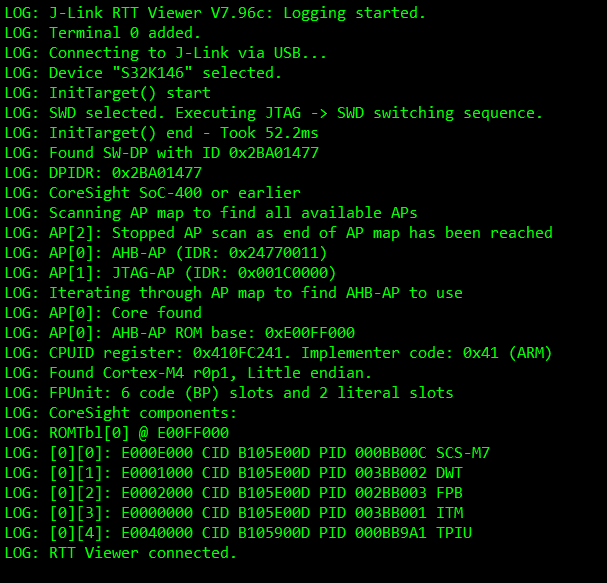

Today while testing we got stuck in MCU halt state again. Everything was working fine since last 3 weeks. We have bypassed VLPR state completely. Now we go from Run to VLPS directly (no VLPR in between). We have also confirmed this from clock frequency the bus clock was 4Mhz and system clock was 8Mhz. We also confirmed that before going to VLPS the clock source was SIRC and all other clock sources were disabled.
In MCU halt state, we connected JTag and was able to connect using RTT Viewer. Following is the screenshot of RTT viewer in MCU halt state.
Nothing is working to bring the MCU alive. The only way we are sure that will work is the power cut. We have our MCU currently in this state and we will wait for your reply if there is something you want us to try in this state. This is because it is hard to reproduce this issue and we don't know when it will happen again. Waiting for your reply.

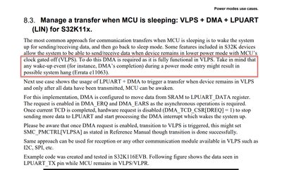

When we goto VLPS we observed that only DMA 0 is enabled. We checked the status of DMA using
for (int ch = 0; ch < 16; ch++) {   // S32K146 has 16 channels
    if (DMA->ERQ & (1 << ch)) {
        printf("DMA channel %d is ENABLED\r\n", ch);
This for loop is used only in debug version and not in release. We are not explicitly disabling DMA 1 and 3 but observed that they are still disabled maybe by driver function static void LPUART_DRV_StopRxDma(uint32_t instance).
We have tried to disable the DMA channels explicitly before going to VLPS using status_t EDMA_DRV_Deinit(void).
Our intention is to make sure that DMA transfer is stopped before entering VLPS state. Is our approach correct?
This statement however has nothing to do with MCU halt issue we are currently facing. We have observed that we got the halt state with and without the above steps. Just want to ask if there is a need to explicitly call status_t EDMA_DRV_Deinit(void) before going to VLPS.

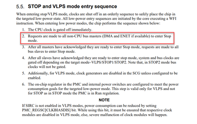

Yes, when entering VLPS, a request is made for non-CPU bus masters to enter Stop mode:
You have to be mindful with DMA configuration for VLPS mode. This is related to ERR011063:
However, if this issue is still happening when DMA is disabled, then maybe the issue is not directly related to this. EDMA_DRV_Deinit() function is correct approach if DMA is not needed in VLPS or directly after.
