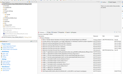

Hello

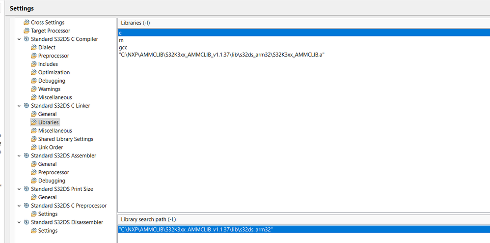

I just started using the development board MCTPTX1AK324 for product debugging and There are some errors while building the software MCTPTX1AK324_Triple_PMSM_RDB. pls see below picture.

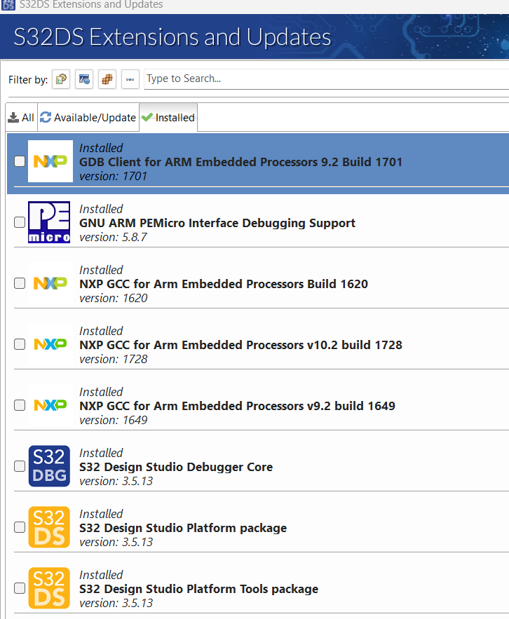

The version of the IDE : S32DS v3.5.
The RTD pack is: S32K3 RTD AUTOSAR R21-11 Version 4.0.0. P16
IPCF : SW32K3 IPCF 4.1.0 D2312
The development package is the: S32K3xx development package version 3.5.13

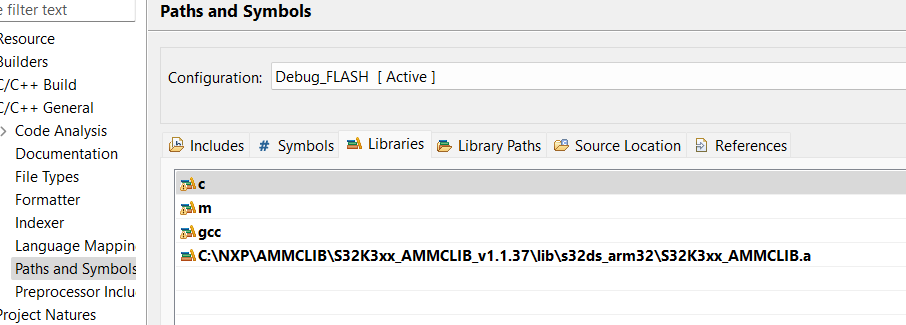

The configuration of the project is shown in below images
Could you please help me check these errors?

After installing MCTPTX1AK324-SW.exe, the MCTPTX1AK324_ReleaseNotes.txt mentions:
Examples based on the RTD low level API(applpostfix _ll):
- S32 Design Studio for S32 Platform Version 3.5
- S32K3xx development package version 3.5.2
- S32K3 RTD AUTOSAR 4.4 Version 2.0.0 (S32DS Extesnion and Updates installation)
- FreeMASTER 3.2.1.6
Please refer to Getting Started with the MCTPTX1AK324 Evaluation Board to install S32DS v3.4 + S32K3 RTD 2.0.0 + IPCF 3.6.0.
Before installing
2.0.0   S32K3 Real Time Drivers Version 2.0.0
, please complete the installation
3.4.3_D2205   S32 Design Studio for S32 Platform v.3.4 Service Pack 4 with support for S32K341 device

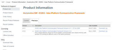

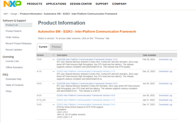

When I download the IPCF3.6.0,I can not find this version, only V3.7.0. in product list. Pls see below picture. How can I get the 3.6.0? If you could share the link with me, that would be even better. Thank you.

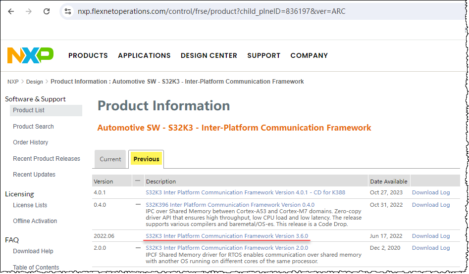

Please click Previous:
