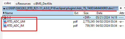

petervlna
API documentation is present directly at plugins:
For example ADC:
There is doc folder where you can find implementation and user manual.
best regards,
Peter
1,930 Views
Embedded_novice
However, this seems to only include the outermost encapsulation interface. I was able to find the function Mcu_GetPllStatus, but the deeper-level function implementations within it, such as Mcu_Ipw_GetPllStatus, cannot be found in the manual. Can I understand it as follows: The manual only presents the API of the outermost layer, while the internal implementation API can only be understood through the comments?
