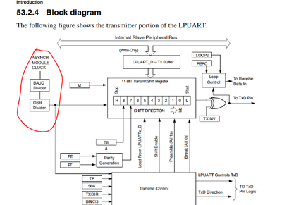

Hi, I am using LPUART1 as an instance for using s32k sdk LIN STACK with baud rate = 19200bps and Im having the following issue:
The LPUART module seems to have 2 different divisors for the input clock configured for this peripheral:
The BAUD divider (sbr), which is just a modulo divide rate, and the OSR divider (osr), which is an oversampling ratio for the baud rate generated.
I´m trying to improve the accuracy of the baud rate generated for the LIN communication, so i´m trying different clock configurations, because reference manual says that FIRC and SIRC clock have different deviation accross temperature:
Following this image, i was expecting that using FIRC clock with this peripheral, the baud rate accuracy will improve, but my results are showing the following:

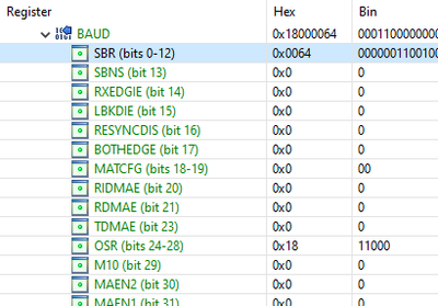

I just tested it with the S32K118 EVB and lpuart_echo_s32k118 (RTM 4.0.2) example.
Only changes:
  • PTC3 as TX
  • FIRC_DIV2 48MHz LPUART functional clock
  • SBR 0x64 = 100, OSR = 0x18 = 24

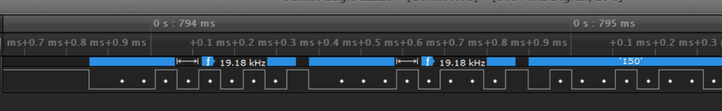

And the TX signal looks correct:
Can you please scope the following:
  • TX signal
  • LIN signal
  • FIRCDIV2 at CLKOUT
BR, Daniel
