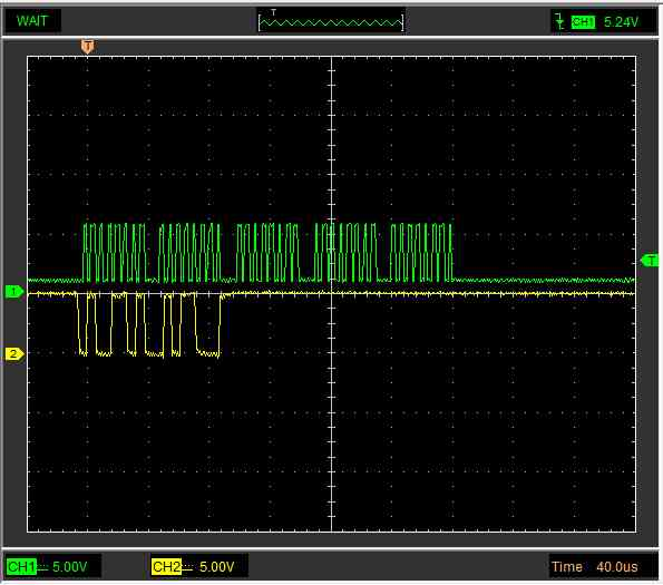

where one would expect for the slave to send just 5 bytes upon master request. However, the slave sends only two bytes.
When trying, instead, to receive only 5 bytes it works without problem. I.e. the following line works:
LPSPI_DRV_SlaveTransfer(RECEIVE, NULL, slave_buffer.rx, 5);
In the following figure one can see that the slave indeed sends only two bytes (yellow signal is the Serial Data Input pin for the master) upon master request (green signal is SCK).
Can someone from NXP comment on this?

dragosrachitan
Hello Davit,
This problem was investigated and a bug was found. Until the bug is fixed, please use both Tx and Rx buffers for the LPSPI_DRV_SlaveTransfer() function while using DMA.

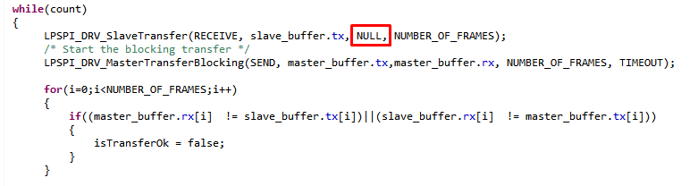

I have tried with the lpspi_dma_s32k144 SDK example.
The only modification:
Yet it works.
Can you try this example?

davithakobyan
Hi Daniel,
Thanks again for your feedback and efforts.
Please find attached the project. It is just newly created from the example as you showed in the picture.
The problem with the original example with setting NULL in place of slave_buffer.rx still can be seen. Once a breakpoint is hit after the line:
LPSPI_DRV_MasterTransferBlocking(SEND, master_buffer.tx,master_buffer.rx, NUMBER_OF_FRAMES, TIMEOUT);
the muster_buffer.rx is mostly field correctly, except the last 4 records. The last 6 bytes of master_buffer.rx looks like the following:
