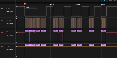

I am struggling with the LPSPI module on the S32K144. I want to send some bytes and receive some bytes of varying length. This works with the exception that I have to send an additional dummy byte. Let's say I want to Tx 2 bytes and Rx 2 bytes, I have to Tx a total of 5 bytes. What am I missing to only have to send 4 bytes to write/read 4 bytes?

clear CONTC bit in TCR.
See attached main.c file I used in S32K144_Project_LPSPI demo.
It gives right frames. I tested below sequences
BR, Petr

for each write to TDR you should increment your totalBytes. For each TDR write there should be RDR reading. After CONT is cleared you should read RDR finally. Try below one, but I did not tested that.

rmaier
Hello Petr,
Thanks for your support. The first read attempt always stays forever in the while RDF mask loop. Even with your code. Any idea why?
