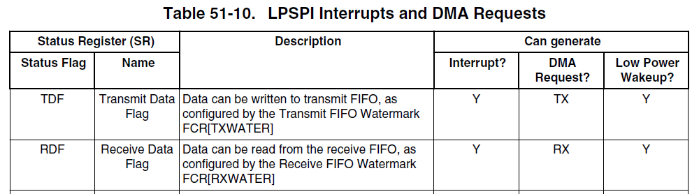

If we take a look at the LPSPI module alone, the DMA transfers cannot be triggered/completed at the same time.
The TX DMA channel writes data to the LPSPI TX FIFO and starts an LPSPI transfer.
Once RX data are available in the LPSPI RX FIFO, the RX DMA transfers can start.
BR, Daniel

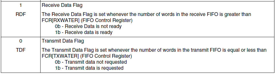

Hi Koorosh,
Yes, there is a delay.
The DMA TX transfer starts before the CS is asserted.
The DMA RX transfer starts only once there are some data in the RX FIFO, when the RDF flag is set.

danielmartynek
Hi hajianik@gmail.com,
I don't know how exactly you implemented it.
But in general, the DMA transfer from the LPSPI RX FIFO can start when LPSPI_SR[RDF] == 1 which means that, at that time, at least a part of the SPI transfer has been already completed.
