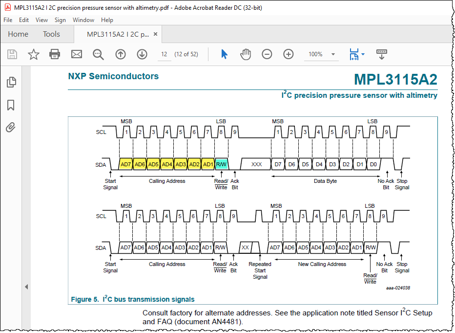

When I send the data to read the slave register the Salve address is getting shifted to right by one bit
LPI2C0_read(0x36,0x0b, id, 1);
For 0x36 I am getting the 0x1b(Shifted by 1 bit)
7,508件の閲覧回数
Robin_Shen
Take the MPL3115A2 data sheet and engineering as an example:
Figure 5. I2C bus transmission signals.pngFigure 5. I2C bus transmission signals.pngI2C Address MPL3115A2.pngI2C Address MPL3115A2.png
Please check the data sheet of your slave device.
