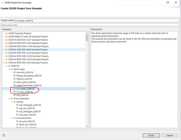

I am developing a project with Linbus using the NXP S32K116 microprocessor. I need to understand whether the slave device receives the data where the master device sends the data, that is, whether there is communication. Is there a ready function prototype used for this?
1 返信
1,003件の閲覧回数
Senlent
Hi@michelangeliousas
you can refer to the below demos we provided for you.
You can download these two demos in two S32K116EVB,one for Master and another for Slave node.

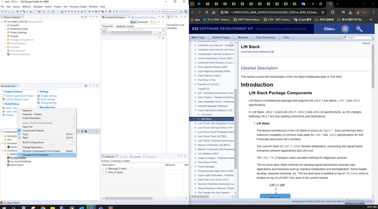

Also you can find some help documents in your install path.
