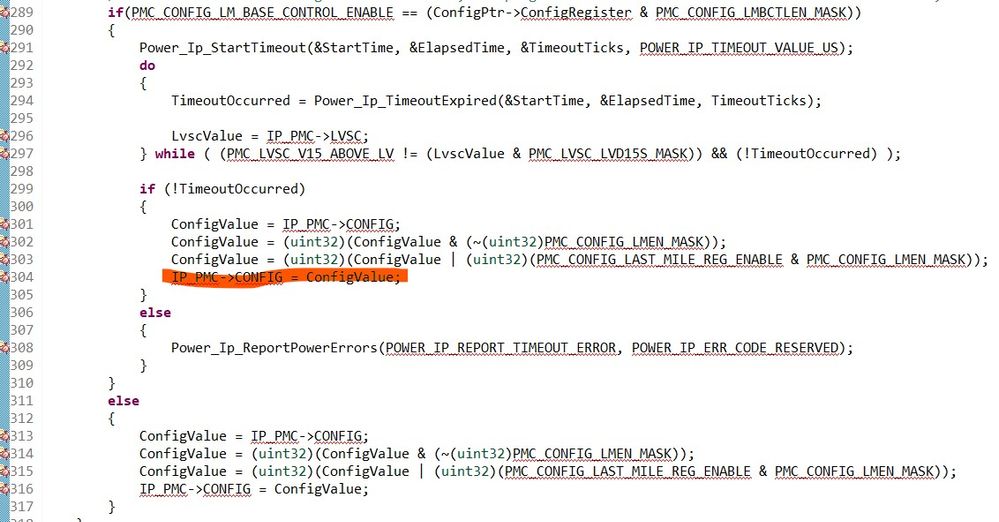

Hello All,
So finally we can build the LIN example. The next problem is that the MCU is not getting over a generated/configured function in the file : "Power_Ip_PMC.c" in function "Power_Ip_PMC_PowerInit" exactly in this piece of code (highlighted line, line number 304):
If we go with debugger over the highlighted line , we are in some kind of deadlock/reset loop of the S32K3. Debugger is not working, we can not reset MCU. So we have to erease the whole memory of the chip with J-Flash Lite.
If we do this again with the debugger and just set "ConfigValue" (before execution in line 304) just to "0" we have a normal run.
Can anyone explain why? And where exactly we can find the configuration menu for this ConfigValue in S32DS? What is a optimal configuration for this register?

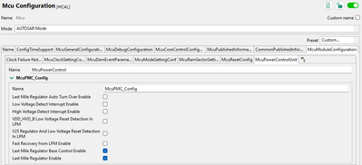

PetrS
PMC is configured in
With above setting I was able to pass outlined code when set VDD_HV_A to 3.3V using J18.2-3 jumper setting.
Or if V15_MCU is sourced from ballast transistor using J31.2-3.
BR, Petr
