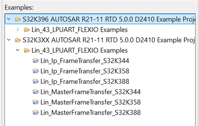

I am using S32K311NHT0MLFST for my project.
I am trying to configure the UART[0] as a LIN driver. Is there any example code available for the particular controller or a controller from the same family.
FIFO option is supported for this particular controller. So it would be very helpful if i can get some example on how the FIFO will be configured.

danielmartynek
Hi Kiran,
We don't have RTD LIN examples for all the S32K3xx derivatives.
This is RTD 5.0.0:
But there are LIN Stack examples for S32K311 too, they use the driver.
The driver does not use the FIFO.
It would increase the complexity of the driver.
