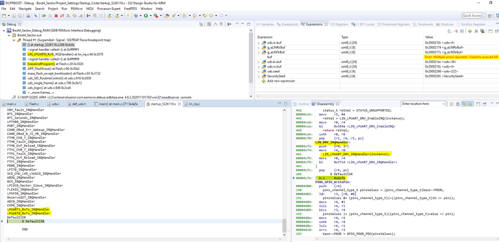

Hello NXP Experts,
I am working on LIN Bootloader .here we are facing issue with  LIN_DRV_IRQHandler when erase memory .when request send from master(CANOE) for erase memory it's going to  LIN_DRV_IRQHandler.

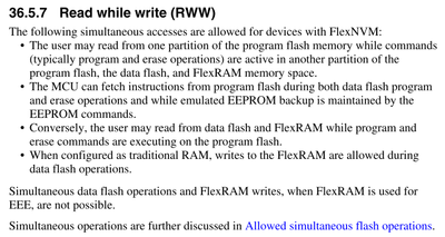

I can see that the bootloader is executed from code flash memory. So, it is caused by read while write error:
Code flash on S32K116 consists of one read partition only. So, you are not allowed to access the code flash when program or erase operation is being executed on code flash.

More read partitions are available only on S32K146 (two partitions) and S32K148 (three partitions). All smaller derivatives of S32K1 have one partition only in case of code flash.
