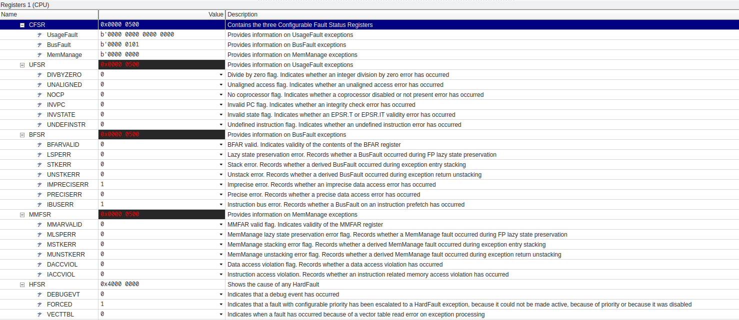

However, after following the procedure documented in the Link above (and the other internal project), c1 is not booted. By attaching with a debugger, I can see that a hardfault has occurred at 0x00000000. Additionally, the SP and PC registers contain garbage values (0x2C6F7920 and 0x2E707040).

What type of fault exception is it?
Can you read the Configurable Fault Status Register (CFSR) ?
https://developer.arm.com/documentation/ddi0403/d/System-Level-Architecture/System-Address-Map/Syste...
It could be related to the MPU and Cache.
BR, Daniel
1,365 Views
x86
Here's a readout of CFSR, UFSR, BFSR, MMFSR and HFSR.

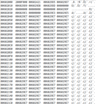

For reference, here is an excerpt of the Flash at the location of the bootloader, which starts at 0x400000 and is prefixed by the NXP boot header entry (8KB)
And here is the application, which starts at 0x600000 and is prefixed by our own application header (also 8KB)
From these images, to me, everything looks to be where it is expected.
