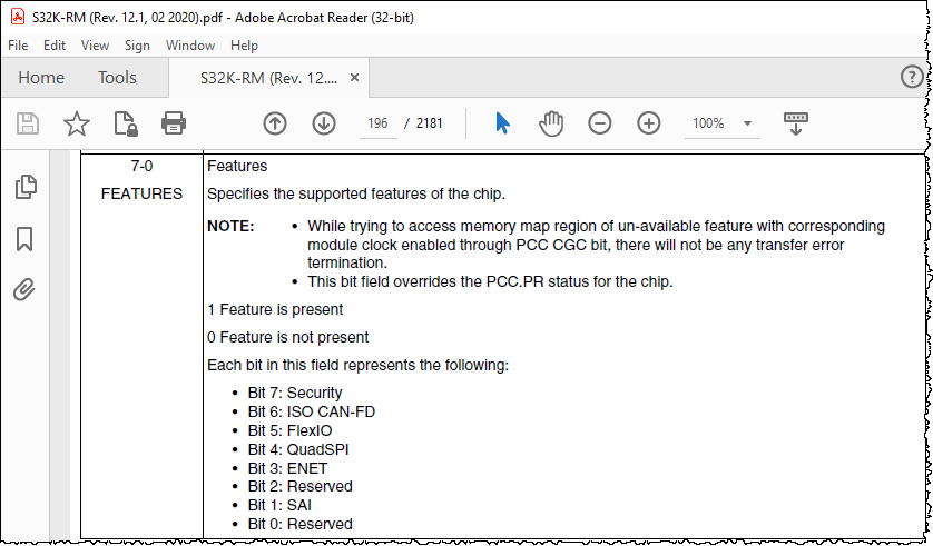

we are trying to identify different micros via its internal register.
Right now we have these two micros:
FS32K148HAT0MLU

For the identification of the part number we proceeded as follows:
reading of the SDID register under SIM memory map, reading of the SMC_PARAM register and for reading the initials present like ethernet we rely on the reading of the PCCs.
In short, by combining and masking the above registers we should be able to identify the uP and its characteristics.
In reality, with this procedure the two micros above are identical, same T°, same speed (both can go to HSRUN while it shouldn't be like this), same peripherals present, eg ethernet.
1,606 Views
Robin_Shen
Hope it helps:
Robin
