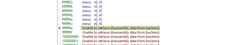

When i set a breakpoint on the last instruction i.e __asm("mov pc, r1"); it jump to unknown code:
But as you can see in the register view, i can see that sp is set to 0x10000 and pc is set to 0x10004.
I tried different addresses for setting PC, as 0x10410 but it doesn't jump at my start code application, i know it since i have set a Debug flag as in this article and a breakpoint with a condition on r11, and it never reach my flag..

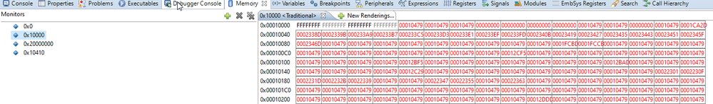

As you can see values at 0x10000 and 0x10004 are 0xFFFFFFFF

BriceC
Hi Daniel,
I found that a part of the SREC was not correctly flashed because of a missing equal in
if(address>=APP_IMAGE_START)
Now my code is jumping correctly and i can see my debug flag, thank you for your help !
