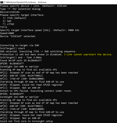

Ankit_Rana
Hello there Geeks,
I was facing flash protection issues, I was able to understand the root cause.
in earlier problems mass erase was enabled and protection was set.
So I was able to unsecure the device using Jlink command line interface and procedure shown in one thread of NXP community. I made one document of the process and attached here.
I have attached document please go through it. it is showing my understanding on this issue and how to recover. please let me know if anything is wrong in my understanding.
Now I'm having device in below state:
It says :Protection is set but mass erase is disabled. J-Link cannot unprotect the device.Ankit_Rana_0-1710850883555.png
Device went into this state while working on boot loader and application.
(as mentioned in attached document I'm not modifying startup file/.S file) , So all flash configuration fields are as it is. startup file of boot loader and startup file of application is not modified at all.
Please let me know if there is any way out and get the device back in normal state.
Please go through attached document and let me know what I should take care so other device will not get damaged.
