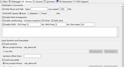

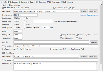

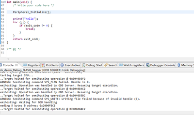

hello! I'm use printf function to print message on console, but not worked. My debugger is Jlink V9,  here is my project settings:
Vandarkholme_1-1721369550737.pngVandarkholme_1-1721369550737.pngVandarkholme_2-1721369560027.pngVandarkholme_2-1721369560027.png
So, is there anyway to print messages on s32ds console? Or only use uart/RTT?

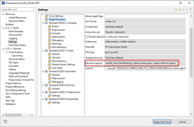

Please enable semihosting by declaring and calling initialise_monitor_handles().
#include "Mcal.h"
#include "stdio.h"
volatile int exit_code = 0;
int counter, limit_value = 1000000;
extern void initialise_monitor_handles(void);
int main(void)
	initialise_monitor_handles();
    for(;;)
    	counter++;
        if(counter >= limit_value)
            counter = 0;
            printf("Hello World\n");
    return exit_code;

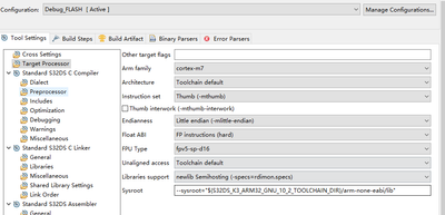

Also, make sure that a library that supports semihosting is configured:

@Julián_AragónM  thanks! Very useful!
