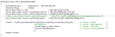

shravani
Hi @petervlna ,
I am able to disable JTAG successfully by using the password, Now I want to disable it by dynamic challange. For this I have provisioned a key AES key to secure nvm and giving the handle of this key as pAttr value but I am getting HSE_IP_SRV_RSP_NO_RESPONSE from HSE. Please refer below snap of my code,

petervlna
As this is public community, for secure related questions like HSE, please rise a ticket a NXP.com.
