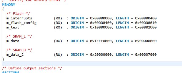

We have ported the bootloader application note code (AN12218SW), for S32K148, to S32K144 and have been facing an issue.
As soon as we start debugging, the code does not stop at the default breakpoint at the "main" function, instead goes to the default ISR. This does not happen if I change the m_text section to be from address 0x00000410 (just for debugging purpose)
Here is the memory section in the linker file for the bootloader project.
The project was built with RTM 3.0.0 SDK, hence we had to change the flash driver from the example code to the one generated by the Processor Expert. I don't think this flash driver has created any problem yet.

Can you update whether this issue has been resolved with Segger devices? I am experiencing the same issue when I try to use the FlexNVM as P Flash which has been partitioned fully to be a P flash i.e full 64KB for Bootloader. I am using Segger Jlink along with NXP S32 design studio on Linux. The same code works fine if I write it to P Flash. The issue crops up when I use FlexNVM as below. Please let me know whether my linker description is correct. The code is being run on S32K144 on a custom board. Please suggest how to fix this with out buying additional hardware.
/* Specify the memory areas */
MEMORY
/* Flash */
m_interrupts (RX) : ORIGIN = 0x0000000, LENGTH = 0x00000400
m_flash_config (RX) : ORIGIN = 0x00000400, LENGTH = 0x00000010
m_text (RX) : ORIGIN = 0x10000000, LENGTH = 0x00010000 /* 64KB for Bootloader*/
/* SRAM_L */
m_data (RW) : ORIGIN = 0x1FFF8000, LENGTH = 0x00008000
/* SRAM_U */
m_data_2 (RW) : ORIGIN = 0x20000000, LENGTH = 0x00007000

jorge_a_vazquez
Hi Manuj Agrawal
It seems SEGGER tools are not supporting FlexNVM programming or has some issues with some projects. We are contacting Segger for this issue, we will update this thread asap.

jorge_a_vazquez
Hi Manuj Agrawal
At the moment the issue is only with Segger interface, so if you use the OpenSDA with P&Emicro interface or you use an external programmer like multilink, then there shouldn't be an issue.
Regarding your program, when I download it, there wasn't any problem reaching the main().

jorge_a_vazquez
Hi Manuj Agrawal
The issue is not related with your project, it is related with the programming interface that you are using, the demo is programming the flexNVM memory (0x10000000). I was able to program your project using the P&EMicro interface of the OpenSDA.
