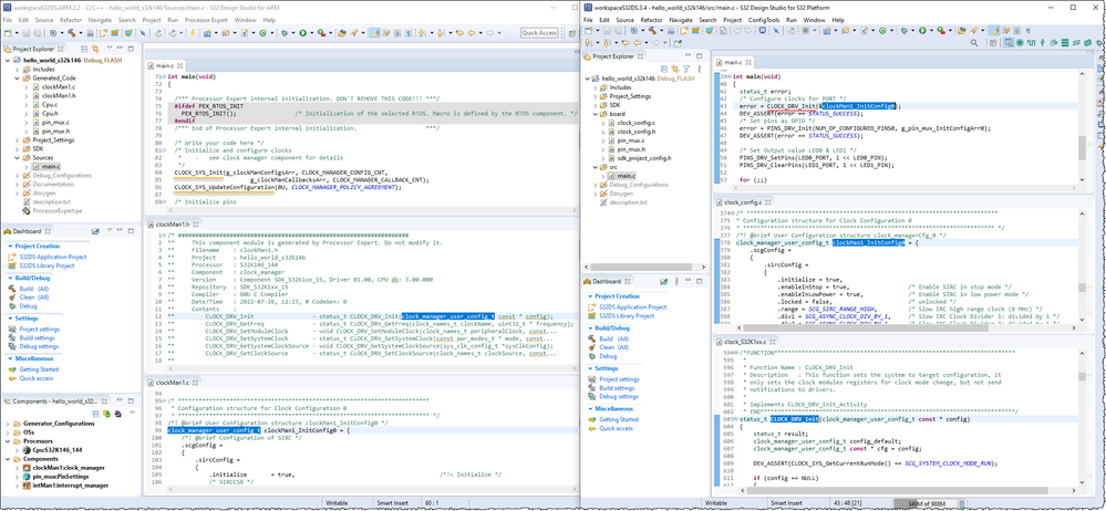

dhirajtarole
Hi @Robin_Shen ,
Thanks for support.
I have checked your suggested code its working now.
Dhiraj

Robin_Shen
Hi dhirajtarole,
https://community.nxp.com/t5/S32-SDK/SDK-problem-in-S32-Design-Studio-for-ARM-2-2/m-p/986190 Here you can find some information between CLOCK_DRV_Init and CLOCK_SYS_Init.
What's the version of S32K1xx SDK are you using? Maybe you can refer to the CLOCK_DRV_Init usage in hello_world_s32k148 of S32K1xx SDK RTM v4.0.2 Example Projects.
Robin
