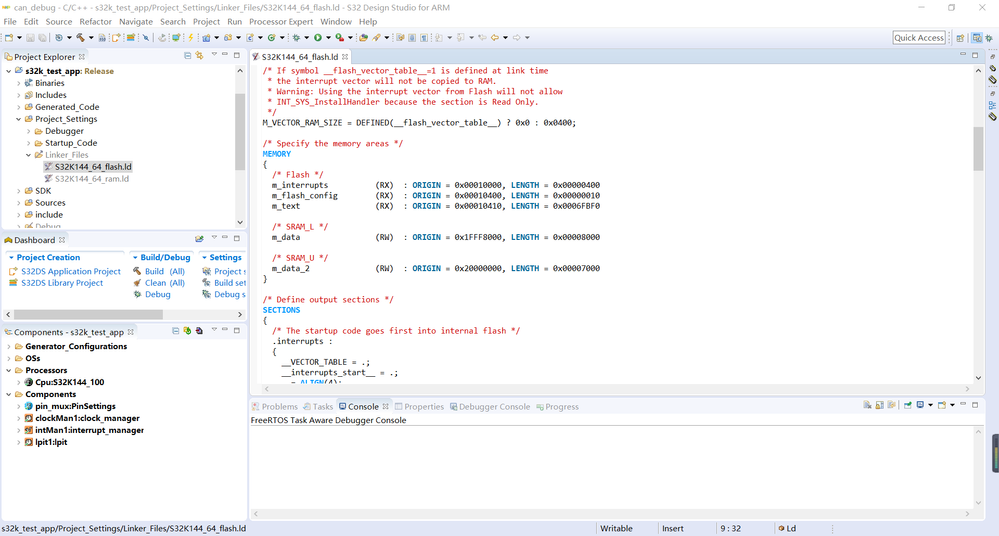

Now I am implementing the app upgrade via bootload. But because of the time constraints, I need a sample program to implement this function faster. I hope to get help. Thank you.

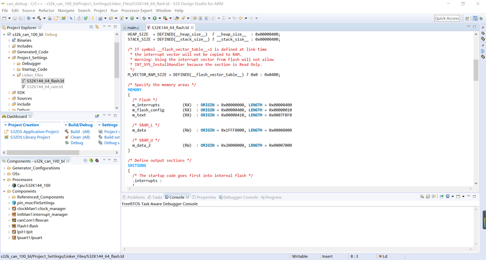

dianabatrlova
I have checked your linker files and the bootloader address space and the application address space overlaps.
For example, if you want to start of the application at address 0x0001_0000, the bootloader address space starts at address 0x0000_0000 and the end address can be 0x0000_FBF0.
Also, after you loaded the application into memory, please, check the application in the memory window in the S32DS.
Window -> Show View -> Memory (if it is programmed correctly)
Do you program the application using Srecord?
I hope it helps.
Diana
