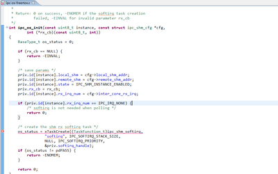

hello, I encountered difficulties with integrating IPCF.
When I set FreeRTOS only with static allocation options, IPCF compilation reported an error. Is it necessary to enable dynamic allocation?

mikesteven
Hi @DanNguyenDuy
Thank you for your reply!
If I do not turn on the dynamic memory allocation option, the compilation will prompt the following error. Because the API used when creating tasks in the current IPCF is xTaskCreate, this function must use the dynamic memory allocation option to be used. But if my project does not allow dynamic memory allocation, does that mean I cannot integrate IPCF?
mikesteven_0-1698138551940.pngmikesteven_0-1698138551940.pngmikesteven_1-1698138618472.pngmikesteven_1-1698138618472.png

DanNguyenDuy
Hi @mikesteven,
This issues will be fixed on the SW32K3 IPCF 4.1.0 D2312 package
Dan
4,421 Views
mikesteven
Thank you for your notification! I have seen the modifications in version 4.1.0, thank you to the NXP team for their efforts!
