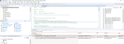

I have tried many methods, but I still can't solve the problem of path. I hope I can get help. Thank you very much

Hi@KeepGoing
         please install IDE: S32DS for ARM v2018.R1 & SDK: S32K1xx SDK RTM 3.0.0,then try again,
as i said above, i don't have the motor kits,so can not  test it for you

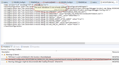

Thank you very much for your answer. I solved a path problem by modifying debug - > debug ram.
Now I'm working on it
Warnings:The launch configuration
MCSXTE2BK142_ PMSM_ FOC_ 2Sh_ Debug_ Lauterbach. launch missing specification of a launch type
As shown in the figure
Finally, I would like to ask you whether my operation meets the specifications and is correct.

Senlent
Hi@KeepGoing
You can download the program and test whether the motor development kit is working properly.
and I don't have such hardware, so i can't test it for you.

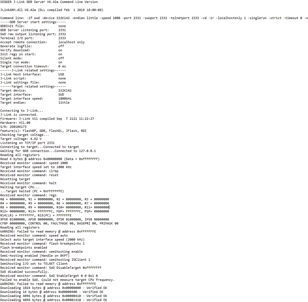

Yes,When I debug, I am prompted that the register reading fails. I don't know how to solve it. I hope I can get your help. Thank you.

Senlent
Hi@KeepGoing
