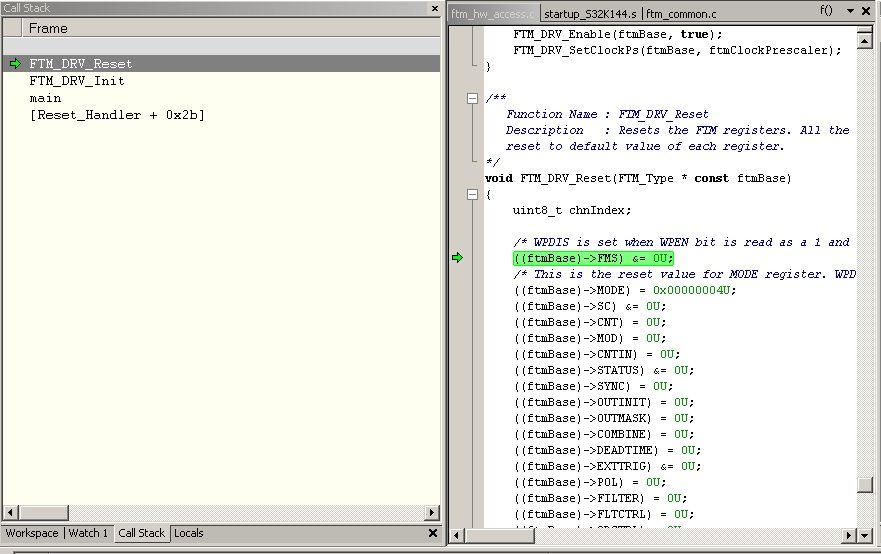

I believe that I don't even reach the handler installation because the Hard failure is risen up after the 1st attempt to set up the configuration for the Fault Mode Status (FMS) register of the FTM0.
Below the sequence visualized:
Here's the start up take place:
Then, after the main invocation, there is the initialization of the FTM0 unit...
Inside that function there is a so called "FTM_DRV_Reset" which try the 1st access to the timer...
Inside the very 1st WR operation is a reset of the FMS:
That operation triggers the exception...

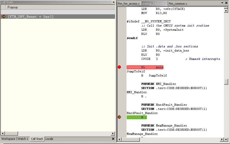

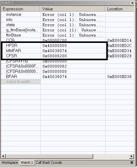

According to HFSR is a forced exception, so I checked CFSR = 0x00008200,
The last access was at 0x40038074 (address of "FTM0_FMS").

raresvasile
It looks like the clock for the FTM instance is not enabled in PCC. This is why it goes to HardFault on the first register access.
Please use clock manager to enable the clock for FTM instance.

I got no the solution for your case but I got a way to investigate about the reason of that fault (I'm trying to resolve a similar issue on a project based a IAR tool chain).
Put a break point into the Hard fault handler position (in the ICF file that point is positioned in the start driver "startup_S32K144.s".
When the failure happen the execution should stop there.
Then check HFSR = HardFault Status Register, which should contain the information about what caused the HardFault handler activation.
