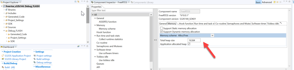

I am using FreeRTOS to run some tasks in my software on S32K144 board . Currently my init task is getting stuck on xQueueSemaphoreTake() function in Queue.c
When I start my program the program runs for a while and then resets and starts with init again. When I see the call stack it shows its stuck on the function i mentioned above. The xQueueSemaphore is invoked while trying to do a blocking receive data from UART peripheral.
In the xQueueSemaphoreTake() function its stuck on portYIELD_WITHIN_API();
I have checked several posts with similiar behavior. I followed their solutions such as stack overflow, or priority setting. I have them all in order.
The configMAX_SYSCALL_INTERRUPT_PRIORITY(5) is number is lower than my UART interrupt(6). I do not have stack issues.
Also when the init task is stuck on the xQueueSemaphore take, the IDLE task is parallely into vApplicationIdleHook() (which i expect is expected behaviour) and then into xPortGetFreeHeapSize() which returns free bytes remaining.
I am new to FreeRTOS and I have exhausted all the solutions online. Can anyone help me?! what could be other possible reasons for this behavior?
Below is the picture of my call stack.

I have figured about what was wrong about this error, this happens due to the lack of heap and stack of the task, so to avoid this increment the configMINIMAL_STACK_SIZE and the Total heap size
Let me know if this helps you.
