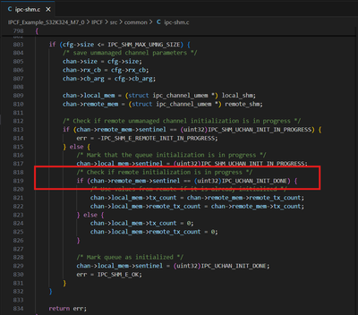

I am currently working on bringing up IPCF on the S32K328 with RTD 7. Since there is no IPCF example available for this device, I first tried running the S32K324 IPCF example on an S32K324 board.
However, when I launch and debug the example, both cores immediately hit a hard fault at the stage ipc-shm.c(linenumber-813) shown in the attached image. I attempted to debug further, but the issue persists.
Could you please provide a working IPCF project for either S32K324 or preferably S32K328?

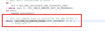

I am facing an issue where both cores are stuck waiting for the remote core ready status.

1. Initially, I was getting a HardFault during IPCF initialization.
2. Even with compiler optimization disabled, the HardFault persisted.
3. When I disabled the MPU Flag, the HardFault disappeared and:
• I am now able to debug both cores successfully.
However, after this point:
• Both cores are stuck in a loop checking “remote core ready”
• The application does not proceed beyond this stage.

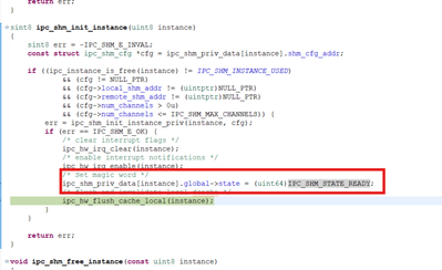

Observations
• Core 0 does set its own ready status correctly, I can see the IPC_SHM_STATE_READY is set on core 0 state
• Even though Core 1 keeps waiting and never detects Core 0 as ready
• Similarly, Core 0 keeps waiting for Core 1
• This suggests the ready status is not being fetched correctly from shared memory

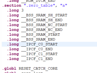

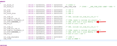

Shared Memory / Linker Investigation
• I noticed that in my initial setup, no explicit shared memory was allocated in the linker scripts for IPCF on either core.
• Based on the IPCF Configuration Tool output, I:
• Allocated 4 KB IPCF shared memory region for both Core 0 and Core 1
• Updated the linker files accordingly
• Made corresponding updates in the startup code (Core 0)
Despite these changes:
• Both cores are still stuck waiting for the remote core ready flag
I will attach the projects too for your reference.
