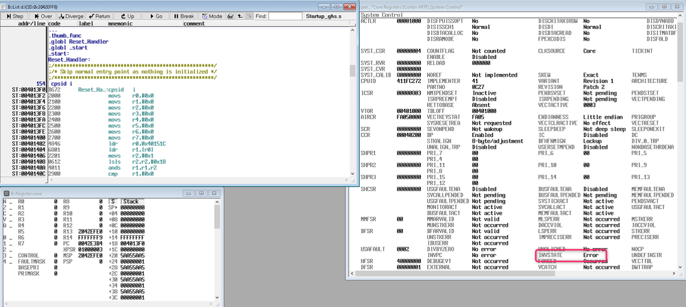

I'm encountering the issue with Trace32 when using it for S32K344 debug.
INVSTATE fault happen at the first line of code (Reset handler). This doesn't happen with T32 09/2020
Can you give me some hint for reason and fix this issue?

Thanks for your response!
This issue seems from my software but I don't know why.
You can see R14 (LR) is 0xFFFFFFFF (very strange) after system.resettarget.
Can you help me to give some reason for this?

Hi Phuong,
with which TRACE32 software version are you encountering this issue?

Hello @rweiss ,
would you please find some time to help with this? Currently I have this version of T32 and I can't see such issue:
