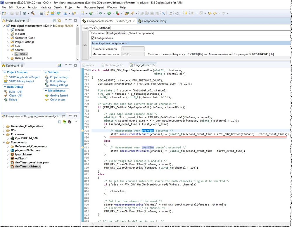

Robin_Shen
Sorry for the delay!
If you enabled the Timer overflow interrupt, you may need to input the callback function. Otherwise it will run into faultISR.
But the FTM_IC driver seems does not count the times of overflow. FTM_DRV_InputCaptureHandler only counts the overflow situation once.
Measurement when overflow occurred.jpgMeasurement when overflow occurred.jpg
Here is the topic once discussed: The issue about FTM input capture for S32K114 and used SDK configuration

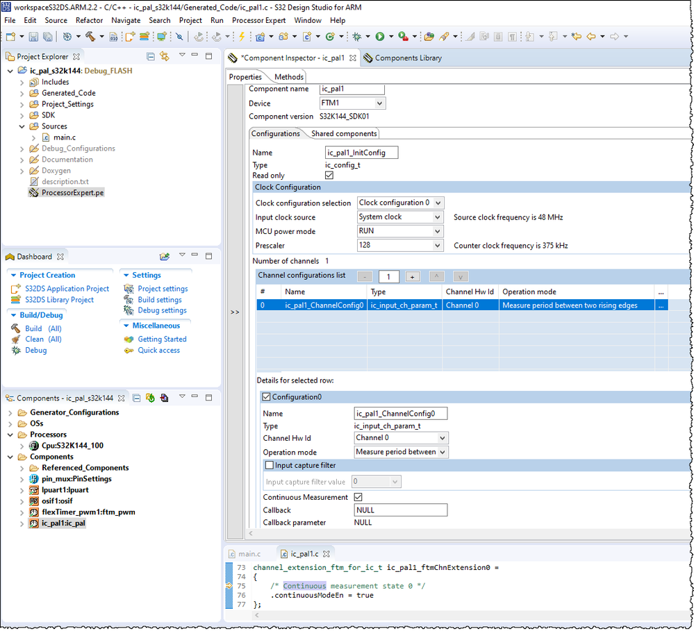

Robin_Shen
Hi yfliu,
Continuous Measurement can be checked for some of the Signal Measurement Mode.
I did not find the call back for counter overflow event.
Would you please have a look at ftm_signal_measurement_s32k144 SDK example. Check whether the ftm_ic meet requirements.
