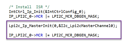

sorry but putting:
IP_LPI2C_0->MCR |= LPI2C_MCR_DBGEN_MASK;
The I2C still not working.
Attached my project.
Regards, Francesco.
2,678件の閲覧回数
danielmartynek
HI @francescovico,
Enable it after the Init function.
Otherwise, the Init function will clear the bit.
