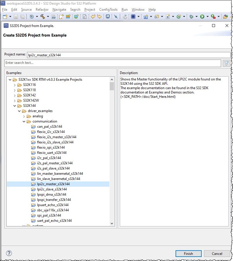

I am implementing an i2c demo example to receive data from a sensor,
the s32k144 will act as a master and the sensor as a slave,
I tried to use an example code but all I found was Master Transmitter codes,
is there a simple Master Receiver code available?
Thank you,
Dema.

Hi Dema,
It looks like you are referring to the S32K144_Project_LPI2C example in AN5413SW.
Please install S32DS v3.4 + S32K1 SDK RTM v4.0.3, there are several I2C examples for reference.
Robin

DemaQasem
Thank you, Robin,
the sensor was detected and I received an ACK.
