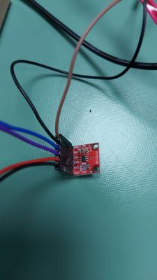

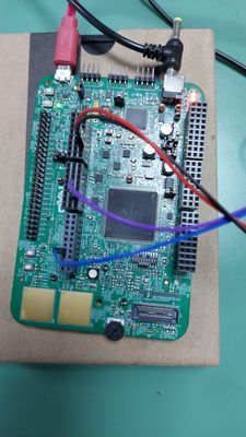

rohit_alate
hi @PetrS ,
NXP -> MCP4725
PTE1 -> SCL
PTC31 ->SDA
J3-13(V5_0) -> VCC
J3-16(GND)->GND

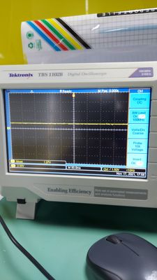

From MCP4725
Out --> +ve scope
Gnd -> -ve scope
No Pullups on I2C Line.
IMG-20211117-WA0000.jpgIMG-20211117-WA0000.jpgIMG-20211117-WA0001.jpgIMG-20211117-WA0001.jpgIMG-20211117-WA0002.jpgIMG-20211117-WA0002.jpg
