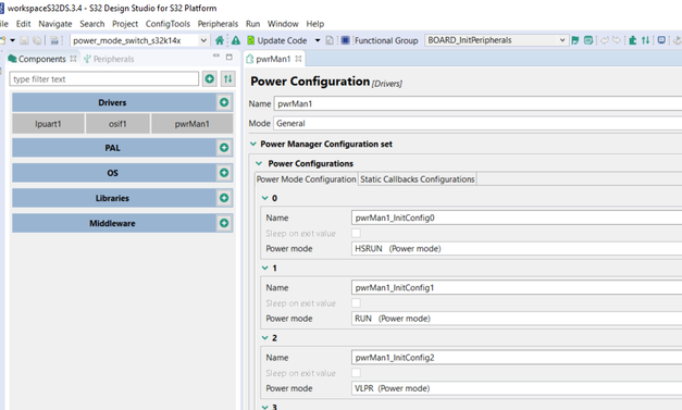

There is no GUI configure for power manager mode. S32DS 3.5 SDK 4.0.1
I can't configure use GUI. Why? I used S32DS for arm 2.2 to configure power mode as usual.But now I migrate to S32DS for S32 3.5, I can't find it.
Otherwise, I use power manager example from the SDK 4.0.1. When I use GUI and generate code.The power module code gone.  I don't understandard.
Can someone help?

Hi @Licunhao,
I have just SDK 4.0.3 installed right now in S32DS 3.4.
As you can see below, it is configurable.
Take a look at the release notes of the SDK.
The SDK does not support S32DS 3.5 but 3.4 only.
S32DS 3.5 is compatible with the S32K1xx RTD.
